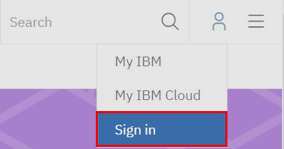

    1. Click the person icon and click Sign in.Sign in

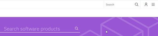

    2. Enter you IBM ID credentials and click Sign in.Search field
    3. Search for Rational Test Workbench.

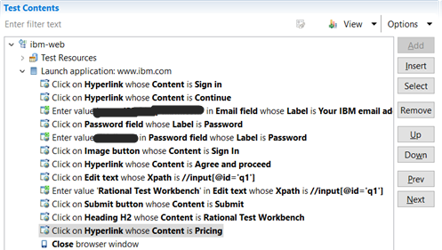

    6. Stop the recording at this point. To stop the recording, in the Recording Control view, click the Stop icon or close the browser window. The test is generated and the test script would look like this: Test script
