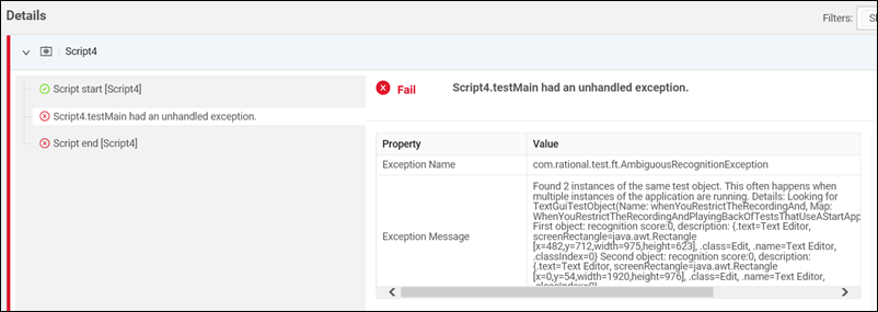

For a single Functional test script or Web UI test, the Details pane of the unified report displays the test details and the test steps. If you generate a unified report for an AFT Suite, the Details pane displays the details of all the available Web UI tests, Functional test scripts and Compound tests. If you generate a unified report for a Compound test, the Details pane displays the details of all the available Web UI tests and Functional test scripts. The Details pane also displays the different iterations for each test run.
When you playback SAP GUI tests in Web UI perspective, the unified report is also displayed in the browser apart from the Statistical Report, and Mobile and Web UI report.
You can perform the following actions on the unified report:
  • When you expand a test by using the icon in the Details pane, you can view all the passed and failed steps for each test. You can select each test step to view the details. Test steps that fail with an exception are displayed with a highlight.
  • You can use the Filters option to filter the passed and failed test suites.
