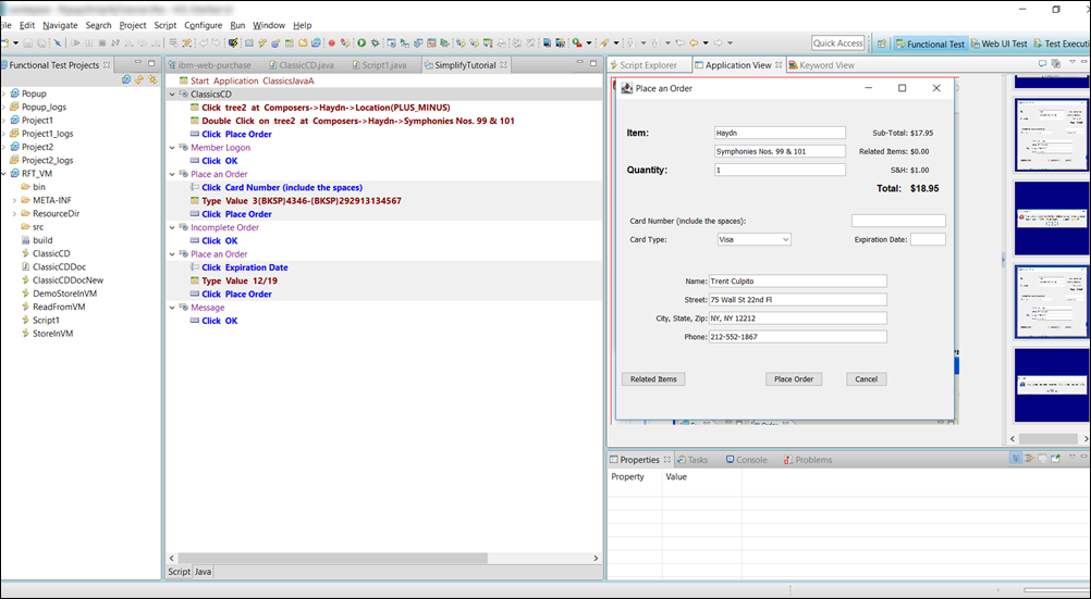

View the simplified script and the application visuals
If the Functional Test window is minimized, restore it.
The generated simplified script is displayed in the Script editor.
To the left of the Script editor is the Functional Test Projects view, which lists any functional test projects to which you are currently connected. All the scripts within each project are listed below the project name. This Projects view provides another way to navigate to different scripts. When you double-click a script in the Projects view, it opens in the script window and becomes the active script.
In the script editor, click the test line
Click PlaceOrder.The application visual of the PlaceOrder is displayed in the Application View. The controls of the application and their properties are captured when you record the simplified script. The application visuals are displayed in the Application View. The application visual highlights the PlaceOrder control in blue. You can click each test line in the script and view the corresponding application visual in the Application View. The Thumbnails pane in the Application View displays the application visuals of all the test scripts in the project that are captured while recording scripts. Notice that when you point the mouse over any of the thumbnails, the snapshot is zoomed and displayed. -
Move the mouse pointer over any control in the displayed
application visual, right-click, and select Insert Comment to
insert any comments on the control.
This feature is useful when you want to check the state of the control or make a note about the control for later reference.
Click Java editor to view the corresponding
Java code of the test script.
Notice that each test line of the simplified script is added as a comment to the corresponding Java code. This comment method makes it easier to map the simplified scripts and the Java code. Do not directly edit the Java code in the Java editor, because changes to the Java code are not shown in the simplified script. If you want to switch to Java scripting to use some of the functions not provided by simplified scripting, then you can use the Insert Custom Code feature and insert the required Java script.
- Click Script to continue working with the simplified script in the script editor.
