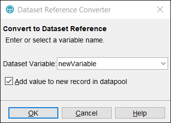

  7. On the Verification Point Data page toolbar, click Convert Value to dataset Reference (Convert Value to dataset Reference) to use a dataset instead of a literal value in a verification point. (If you cannot see the Convert Value to dataset Reference button on the toolbar, make the page larger by dragging a corner of the page).
    The dataset Reference Converter dialog box opens.
  8. In the dataset Variable field, type Price to replace the newVariable for the heading in the dataset.
  9. Select the Add value to new record in dataset check box to add the Price to the existing dataset record you created in the previous exercise.
  10. Click OK.
