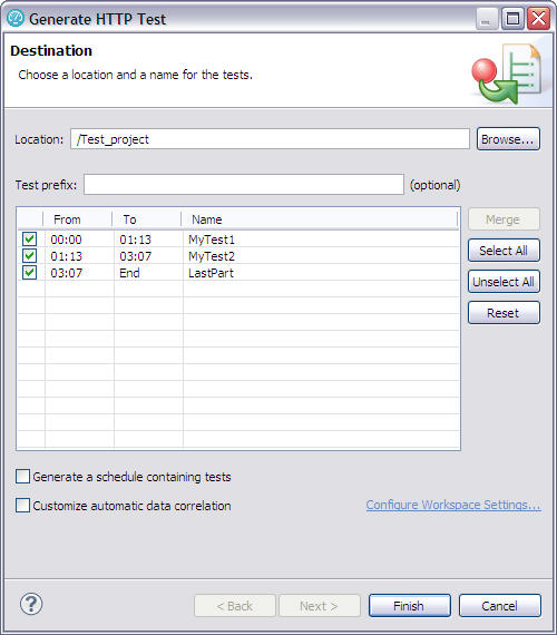

  3. Close the client program to stop the recording. The Generate HTTP Test window is displayed. Generate HTTP Test
    • Type a Test prefix for all the tests in the schedule.
    • Select Generate a schedule containing tests to create a schedule for the tests. When you select this option, you can modify the name of the schedule.
    • Select Customize automatic data correlation to choose automatic data correlation or rule-based data correlation. If you select this option and choose rule-based data correlation, you can specify which data correlation rule sets to use.
  4. Click Finish.
