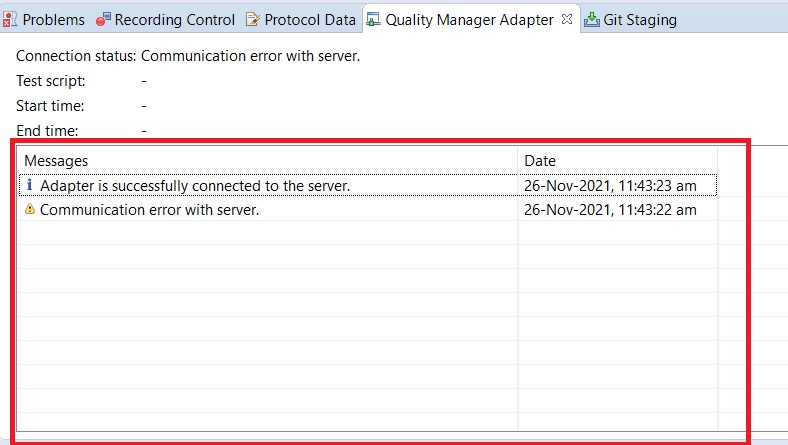

The following image displays the activities of the adapter in the Quality Manager Adapter view:
etm_adapter_activity
