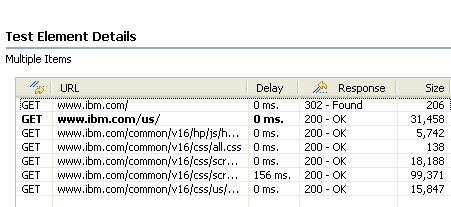

Example
The following example shows results for an HTTP request. Other protocols might display less detailed information. Double-click a table row to locate the element within the test.
HTTP results of clicking Select
