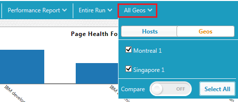

  1. From the Test Navigator view, open the schedule run that includes remote agents. The name of the run corresponds with the name of the schedule and has a timestamp.
  2. On the report toolbar, click All Geos.
    Web Analytic report
  3. Select the regions that you want to compare and click Compare.

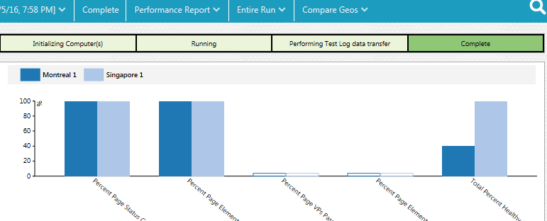

    The report shows the data in the compare mode.
    Report in the compare mode
