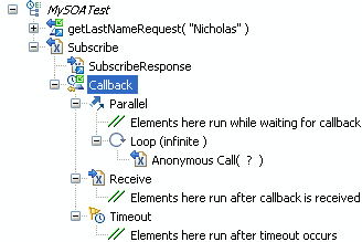

To test asynchronous services, you must create an asynchronous request structure in your test as shown in the following diagram:
Example of asynchronous request structure
A web service request or a plain XML request provides the subscription action and contains a callback element, which describes the behavior of the test in three states:
  • Parallel contains test elements that are run after the subscription request and while waiting for the notification response.
  • Receive contains test elements that are run when the notification response has been received from the service.
  • Timeout contains test elements that are run if the notification response is not received after a delay that is specified in the callback element.
When everything contained in the parallel, receive, and timeout elements have finished running, the run continues with the next element in the test after the asynchronous request.
