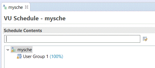

When you create a schedule, it is displayed with one group, as shown in the following image. You can add more groups, tests, and other items to the schedule to emulate a workload.
default schedule with one user group

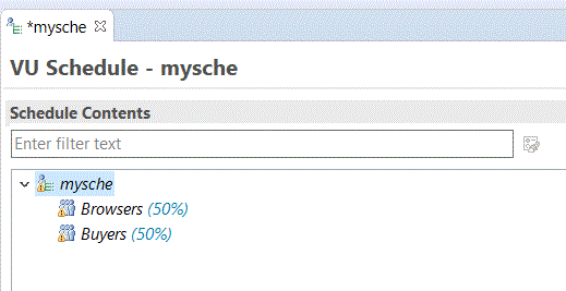

When you add items to a schedule, they appear in italic type, as shown i. The italic type changes to regular type after you save the schedule.
schedule showing changed items in italics
