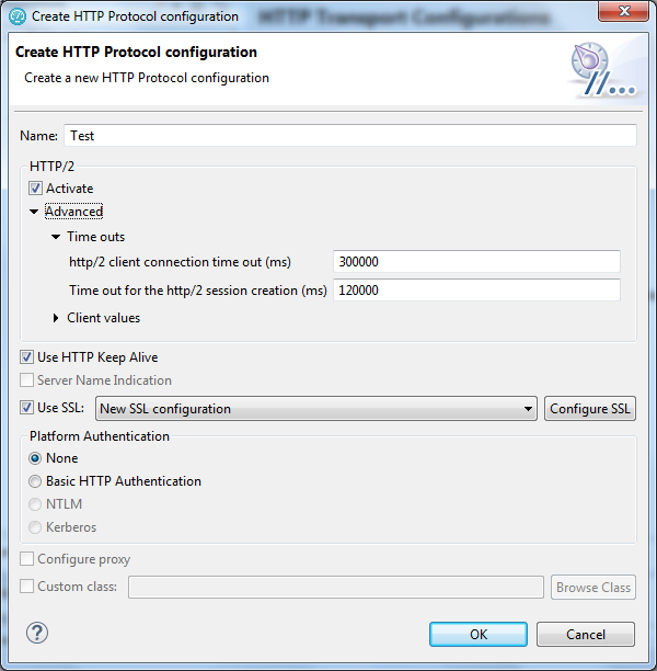

  7. When you record a service by using a web browser against an HTTP/2 client, the HTTP/2 traffic is automatically captured. But, to record an HTTP/2 service by using the GSC client, in the HTTP transport protocol configuration dialog, you must select the Activate check box.HTTP protocol configuration
  8. Specify the following configuration options for HTTP/2:
    HTTP/2
    Note: Testing HTTP/2 service is in the Beta mode. For more information, see Preparing to record a HTTP/2 service.
    To test a service that uses the HTTP/2 protocol, select the Activate check box. This check box is automatically selected when you record a service by using a browser. If you use the Generic Service Client component to create a HTTP/2 test, you have to manually select the check box.

  9. Click OK. You have configured the workbench to test an HTTP/2 service.
