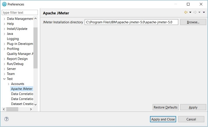

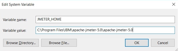

To work with JMeter tests, you must download the JMeter executable from https://jmeter.apache.org/download_jmeter.cgi and unzip it. To run the JMeter test as part of schedule, you must install JMeter on the remote agent machine and set the JMETER_HOME environment variable to the root installation folder. To run the JMeter tests, you must either specify the Apache JMeter path in the product Preferences or set the environment variable.
You can click to access the preference settings for Apache JMeter and point it to the apache-jmeter-x.0 directory.
Where, x is the version number of the JMeter executable.
You can set the environment variable JMETER_HOME and point it to the apache-jmeter-x.0 directory.
