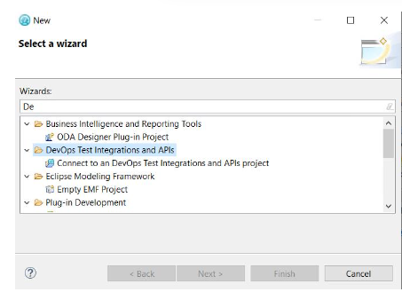

- Right-click the Test Navigatorin Test Performance.
Select and then click Next.
Click BrowseIn the wizard page, and then select the root
folder that contains the project.
If the path contains a project, its name should automatically appear in Project Name and the Finish button should be enabled.
