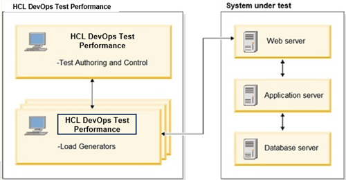

A typical setup of Test Performance workbench, Test Performance agents, and the system under test is shown here:
