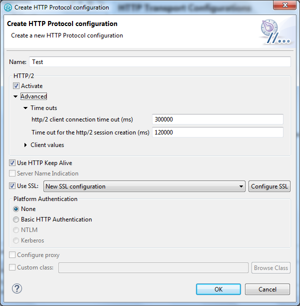

When you record a service by using a web browser against an HTTP/2 client, the HTTP/2 traffic
is automatically captured. But, to record an HTTP/2 service by using the GSC client, in the HTTP
transport protocol configuration dialog, you must select the Activate
check box.
Specify the following configuration options for HTTP/2:
- HTTP/2
- Note: Testing HTTP/2 service is in the Beta mode. For more information, see Preparing to record a HTTP/2 service.To test a service that uses the HTTP/2 protocol, select the Activate check box. This check box is automatically selected when you record a service by using a browser. If you use the Generic Service Client component to create a HTTP/2 test, you have to manually select the check box.
- HTTP/2 client connection timeout
- Specifies the time limit for the HTTP/2 client to connect to the HTTP/2 server.
- Time out for the HTTP/2 session creations
- Specifies the time limit to create the HTTP/2 session. This time starts after the connection is established.
- Enable HTTP/2 Push
- The Push functionality of HTTP/2 automatically identifies and passes the related objects or requests to the client when a request is sent to the server. Clear the check box to not use the functionality.
- Initial session window
- Specifies the buffer size on the sessions.
- Initial stream window
- Specifies the window size for buffer on each stream after the connection is established.
- HTTP/2 Client Input Buffer Size
- Specifies the buffer size that is used to read the network traffic.
- Maximum Quantity of Messages that can be queued
- Specifies the maximum number of messages that can be queued for the HTTP/2 client on a thread.
- Maximum Quantity of HTTP/2 thread pool
- Specifies the maximum number of thread pools that will be used by the HTTP/2 client to distribute the workload.
- Minimum Quantity of HTTP/2 thread pool
- Specifies the minimum number of thread pools that will be used by the HTTP/2 client to distribute the workload.
- HTTP/2 client bytebuffer pool size
- Specifies the buffer size to receive the unciphered values.
- Server Name Indication
- Note: Not applicable for HTTP/2.Clear this check box if you do not want to connect to the host computer by using the Server Name Indication protocol. If the host computer is already configured with Server Name Indication protocol, you should keep this check box selected.
- Use HTTP Keep Alive
- Select this option to keep the HTTP connection open after the request. This option is not available if you are using IBM® Rational® AppScan®.
- Use SSL
- Select this option to use an SSL configuration. Click Configure SSL to create an SSL configuration or select an existing configuration.
