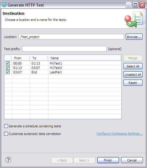

Close the client program to stop the recording. The Generate HTTP
Test window is displayed.
- Type a Test prefix for all the tests in the schedule.
- Select Generate a schedule containing tests to create a schedule for the tests. When you select this option, you can modify the name of the schedule.
- Select Customize automatic data correlation to choose automatic data correlation or rule-based data correlation. If you select this option and choose rule-based data correlation, you can specify which data correlation rule sets to use.
Click Finish.
The Test Generation window displays the status of generating the tests and schedule and the data correlation. You can view the test generation log from this window.
- When test generation is complete, you can select the test to open and then click Open Selected Tests, or you can click Close to finish this process.
