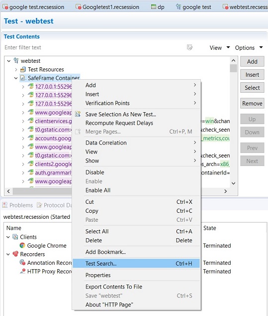

- In the Test Navigator, browse to the test and double-click it. The test opens.
Right-click the test name, and then select Test Search.

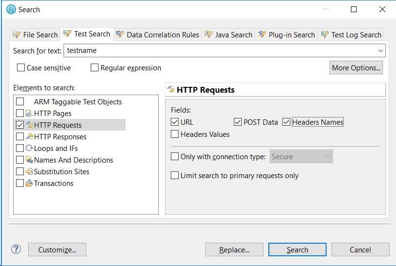

- In Search for text, type the header name to locate.
- In the Elements to search list, select the HTTP Requests check box.
On the right-hand side, where you can define how to search a selected element. Select the
Headers Names or Header Value check box depending on
the input provided in the Search for text field.

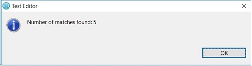

Click Search. The Test Editor window displays
with the number of matches found.

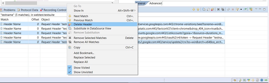

- In the Search view, select a result (press Ctrl key to choose multiple results).
Right-click the selected results and click Delete Header.
