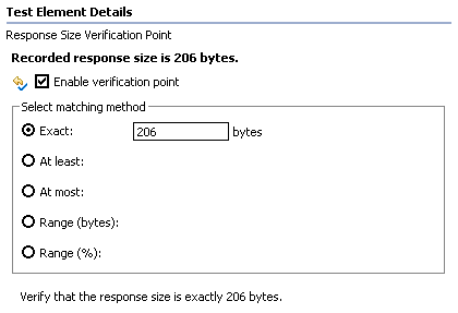

Note: When you modify a test, the modified items appear in italic type. The italic type changes to regular type after you save the test. - Click the verification point to display the response size
editing fields in the Test Element Details area.
Responses to HEAD requests, by definition, have no contents; the size is always 0.
- To disable an individual response size verification point, clear the Enable verification point field.
- From the Select matching method list,
click an option to indicate how closely the response size that is
returned in the page request must match the recorded response size.
- The default matching method for a primary request is Range, with a percentage adjustment based on the value in the field on the right. (You can change the percentage basis as well as the matching method.) When the test is run, an error is reported if the actual response size falls outside the adjusted range.
- For other requests, the default matching method is Exact. When the test is run, an error is reported if the response size does not exactly match the expected size.
