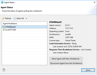

Click the Agent Status
icon
from the product to verify the two container agents are polling the workbench.
Note: The agent host names should match the IDs of the containers running in Docker. Make a note of the IP address of the each agent since they must be used when creating the agent locations. - In the schedule editor, create a new location test asset for each container agent so that the selected User Group runs on two agent locations.
