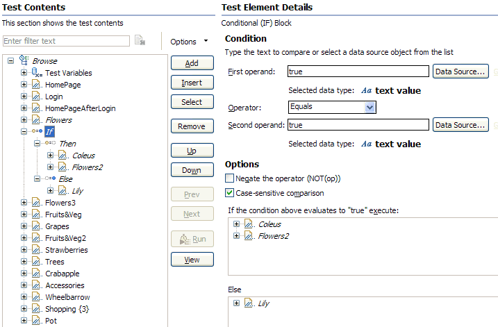

In step 6, if you add an Else block, you can select one or more of these items to be moved into the Else branch.

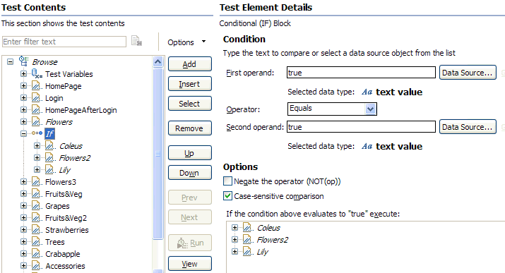

A prompt Would you like to move selected objects into the new IF? is displayed.
- Click Yes or No.
The If block is inserted into the test. If you click Yes, as shown in the example, the items that you selected are moved under If in the Test Contents area. The following example shows an If block with an HTTP test.
- To add an Else block:
In the Test Element Details area, under Condition, add
conditions:
- In the Test Element Details area, under Options, choose the required comparison type by selecting or clearing the check boxes.
