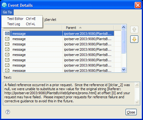

The second column shows the status of the page:Symbol Meaning Green check All requests for the page are successful and that there are no warnings. Red X The page contains requests with failed verdicts or unexpected response codes. Typically, failed verdicts are verification point failures. Unexpected response codes are codes outside the 200 and 300 range that were not recorded as such or that are not represented in associated verification points. Yellow warning symbol The page contains messages but no failure verdicts or unexpected response codes. - Double-click an entry in the Event Log to open the Event Details window. The Event Details window shows a list of events for the page
that is highlighted in the Event Log. The Name and Parent columns show the
name and parent request for each event. The Text field shows details for each event.
Note: The Go To menu at the top of the Event Details window lets you jump to the corresponding event in the test or the test log. This is useful for obtaining more contextual information about the error shown in the table. - Leave the Event Details window open,
and click other pages in the Event Log, or use
the Forward and Back buttons to navigate to other pages in the Event Log.The Event Details window is updated to show the events for the page that is selected in the Event Log.
