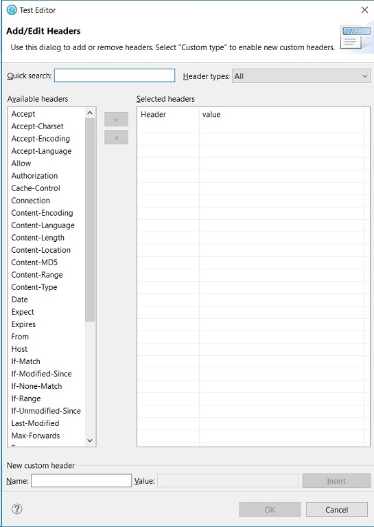

From the drop-down list, select . The Add/Edit Headers window opens.
To add a standard header:
In the Available Headers list, locate the header to add and click it. Type the name of the header in the Quick search field and select the type of header that you are looking for in Header types list to quickly locate a header in the Available Headers list.
Click the right-angle bracket (>). The selected header moves into the Selected headers list and your cursor is placed in the value column.
Type the value for the header.
To add a custom header:
In the Header types list, select Custom.
At the bottom of the window, in the New custom header area, type the header information in the Name field and the Value field, and then click Insert. The custom header is added to the Selected headers list.
When you have finished adding headers, click OK.
