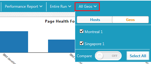

When comparing agents, open the Location asset and in the General Properties tab, add an RPT_GEO property with any value. This value is then displayed in the All Geos menu of the report.
To compare performance data:
- From the Test Navigator view, open the schedule run that includes remote agents. The name of the run corresponds with the name of the schedule and has a timestamp.
On the report toolbar, click All Geos.

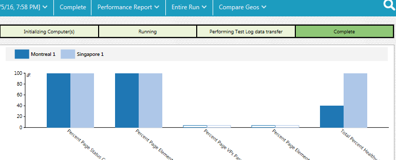

Select the regions that you want to compare and click Compare.
Note: When you compare data from various regions, you cannot compare stages in a run at the same time.The report shows the data in the compare mode.
