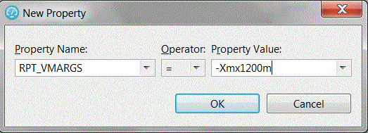

- Under Property Groups, click the General Properties link, and then click Add.
In the New Property window:If you need to set multiple RPT_VMARGS values for a location, place them in the same property entry and separate them with a space. Do not use multiple property entries to set multiple RPT_VMARGS values for a location.The following New Property window sets maximum heap to 1200 megabytes:
