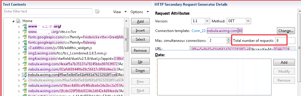

From version 9.1.0.1 or later, you can also specify
the number of requests to be send to the server in the Test Editor itself. After creating the
secondary HTTP request, in the HTTP Secondary Request Generator Details area, specify the total
number of requests. If the number of requests is greater than 0, the number that you specify in
Total number of requests takes precedence over the array variable.
