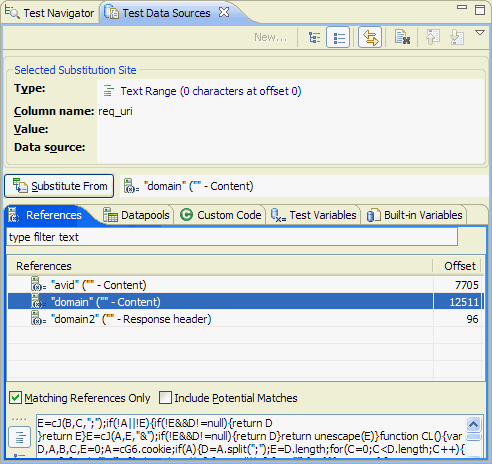

Use the Test Data Sources window to add or change data correlation for any supported test element.
The test generator attempts to perform automated data correlation. You can also manually
correlate request values with other test data. The Test Data Sources window
displays the following types of test data that you can substitute from:
- References
- Datasets
- Custom code
- Test variables
- Built-in datasources
- References
- The data sources that have been created in the test and the potential matches that are available for a selected substitution site. For example, text that is found in a response and used in a subsequent request is automatically created as a reference. Clear the Matching References Only check box to see all the references that occur before the substitution site in the test. Select Include Potential Matches to see a list of locations that might match the substitution site. Replace the type filter text string with keywords to filter the list of references. Select a reference in the References table to display the reference in the pane at the bottom of the window. Use the controls to the left of the preview pane to switch between inline view and tree view.
