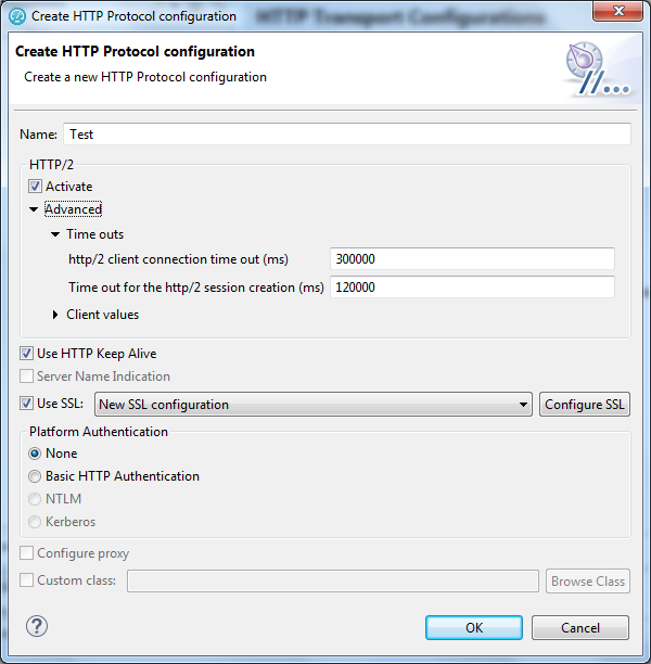

  7. When you record a service by using a web browser against an HTTP/2 client, the HTTP/2 traffic is automatically captured. But, to record an HTTP/2 service by using the GSC client, in the HTTP transport protocol configuration dialog box, you must select the Activate check box.HTTP protocol configuration
  8. Specify the following configuration options for HTTP/2:
    HTTP/2
    Note: Testing HTTP/2 service is in the Beta mode. For more information, see Preparing to record a HTTP/2 service.
    To test a service that uses the HTTP/2 protocol, select the Activate check box. This check box is automatically selected when you record a service by using a browser. If you use the Generic Service Client component to create a HTTP/2 test, you have to manually select the check box.
    HTTP/2 client connection timeout
    Specifies the time limit for the HTTP/2 client to connect to the HTTP/2 server.
    Time out for the HTTP/2 session creations
    Specifies the time limit to create the HTTP/2 session. This time starts after the connection is established.
    Enable HTTP/2 Push
    The Push functionality of HTTP/2 automatically identifies and passes the related objects or requests to the client when a request is sent to the server. Clear the check box to not use the functionality.
    Initial session window
    Specifies the buffer size on the sessions.
    Initial stream window
    Specifies the window size for buffer on each stream after the connection is established.
    HTTP/2 Client Input Buffer Size
    Specifies the buffer size that is used to read the network traffic.
    Maximum Quantity of Messages that can be queued
    Specifies the maximum number of messages that can be queued for the HTTP/2 client on a thread.
    Maximum Quantity of HTTP/2 thread pool
    Specifies the maximum number of thread pools that will be used by the HTTP/2 client to distribute the workload.
    Minimum Quantity of HTTP/2 thread pool
    Specifies the minimum number of thread pools that will be used by the HTTP/2 client to distribute the workload.
    HTTP/2 client bytebuffer pool size
    Specifies the buffer size to receive the unciphered values.
    Server Name Indication
    Note: Not applicable for HTTP/2.
    Clear this check box if you do not want to connect to the host computer by using the Server Name Indication protocol. If the host computer is already configured with Server Name Indication protocol, you should keep this check box selected.
