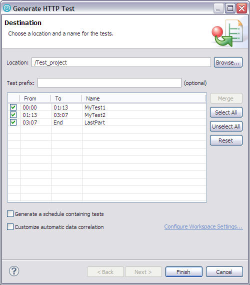

- Close the client program to stop the recording. The Generate
HTTP Test window is displayed.
- Type a Test prefix for all the tests in the schedule.
- Select Generate a schedule containing tests to create a schedule for the tests. When you select this option, you can modify the name of the schedule.
- Select Customize automatic data correlation to choose automatic data correlation or rule-based data correlation. If you select this option and choose rule-based data correlation, you can specify which data correlation rule sets to use.
- Click Finish. The Test Generation window displays the status of generating the tests and schedule and the data correlation. You can view the test generation log from this window.
- When test generation is complete, you can select the test to open and then click Open Selected Tests, or you can click Close to finish this process.
