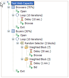

- Click the name of the schedule element to contain the random selector, and then click .
In the Schedule Element Details area, add the number of
iterations to loop.

Set the weight of the random selector. The weight determines
the statistical probability that a specific element will be selected.
Assume that a random selector contains two tests: Browse and Bid. You assign Browse a weight of 7 and Bid a weight of 3. Each time the loop is processed, Browse has a 70% chance of being selected, and Bid has a 30% chance of being selected.
