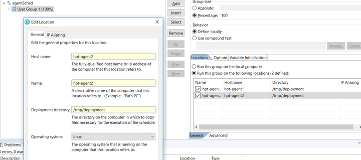

Specify the agent details in the workbench. You can do this in one of the two ways:
- Specify all of the details in the local workbench and export the test assets to the directory that will be used by the containers to choose the tests.
- Bring up the workbench UI in the container to specify the agents in the schedule editor. To bring up the workbench UI in the container, install and configure an X11 server such as Xming on your host machine and specify -e DISPLAY=<IP>:0.0 parameter in the docker run command. The IP is the IP address of your host machine. For information about how to install and configure Xming, see its product documentation.
Note:- If you use 'localhost' instead of the IP address with the default Docker settings, the container will forward the display to itself. If your IP is assigned via DHCP it is liable to change and you will need to update your container’s environment variable accordingly.
- Do not use underscores in the agent names.
To map a User Group with a specific agent, assign a static IP to the agent. To assign an IP to
the agent, use the NODE_IP parameter along with the docker
run command.
Note: Ensure that this IP matches with the IP specified for the Location asset in the workbench.
