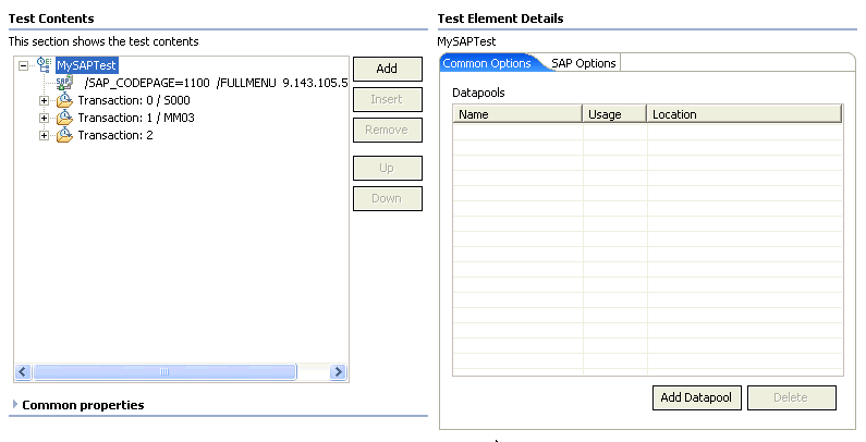

The test editor lists the SAP transactions for a test, by title. The following example shows the test MySAPTest, which was generated from a recording of these tester actions: logon to the server, launch a Material Master Display transaction (mm03), view the Basic Data screen for the item SCREW, and stop recording.
There are two main areas in the test editor window. The area on the left, Test Contents, displays the hierarchy of the SAP transactions for the test. The area on the right, Test Element Details, displays details about the currently selected item (transaction or event) in the test hierarchy. In the preceding example, Test Element Details displays information about the test because the name of the test, MySAPTest, is selected in the Test Contents area.
When you expand a test transaction, you see a list of SAP screens. Each SAP screen corresponds to a new page or window in SAP GUI and is reflected by the screen capture in the SAP Protocol Data view.

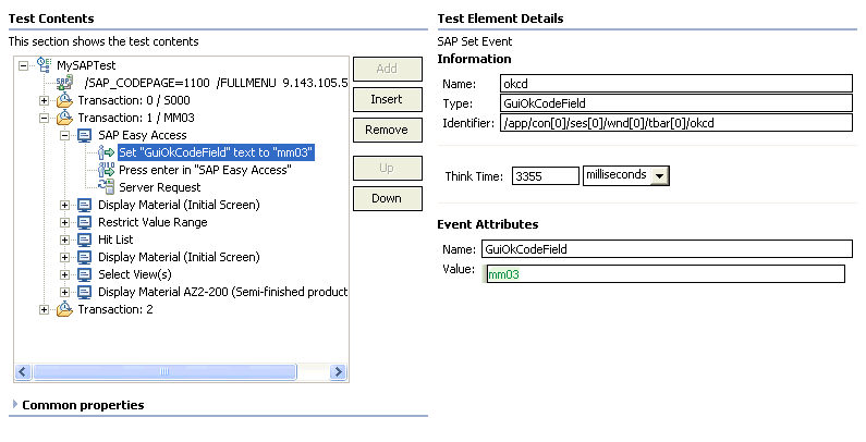

When you expand a SAP screen, you see the SAPGUI events for the screen, with names that describe the action. The following example shows the Material Master Display (mm03) transaction expanded with the SAP Easy Access screen. The set event that described the mm03 text input in the SAP GUI is selected in the Test Contents area.

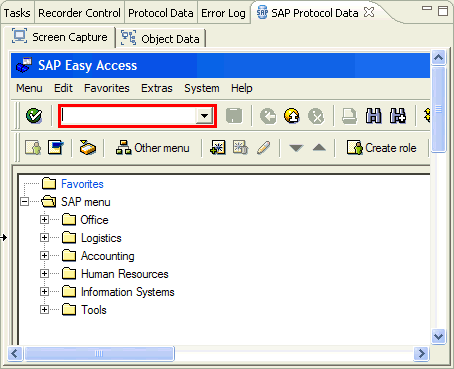

The test editor synchronizes with the SAP Protocol Data view. When you select a test element in the test editor, the corresponding screen is displayed as a screen capture in the SAP Protocol Data view. If a specific SAP GUI object is related to the test element, the object is highlighted in the SAP Protocol Data view. You can also right-click SAP GUI objects in the SAP Protocol Data view to add associated events or verification points to your test.
