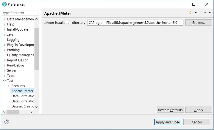

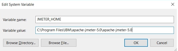

To run the JMeter tests, you must either specify the Apache JMeter path in Preferences or set the environment variable.
Note: When you run the compound test or schedule, an error message is displayed, if you have not specified the preferences or set the environment variable.
  • To access the preference settings for Apache JMeter, click Window > Preferences > Test > Apache JMeter and point it to the apache-jmeter-5.0 directory.
    Setting JMeter Preference
  • Set the environment variable JMETER_HOME and point it to the apache-jmeter-5.0 directory.
    Setting JMeter Variable
