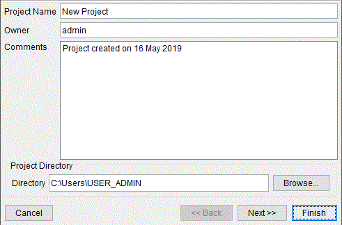

  1. Launch the Integration Tester application from your desktop.
  2. Select Create Project and click OK.
  3. Enter a name for the project in the Project Name field.
  4. Click Browse and select a location to save the project.
    If you do not browse and select a location, the project is saved in the default location, which is your home directory. For example, the default location is C:\Users\USER_ADMIN as shown in the following image.
    Image of the new project window.
  5. Click Finish.

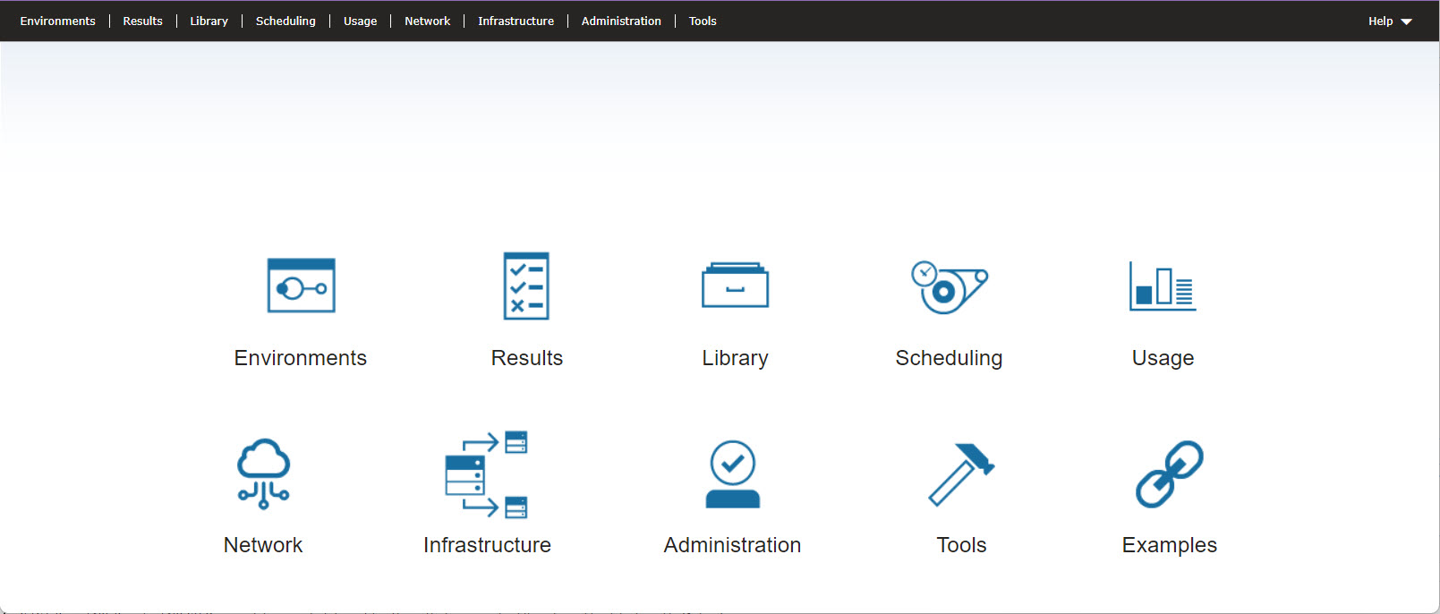

  1. Open Test Virtualization Control Panel by double-clicking the Image of the icon icon.
    When Test Virtualization Control Panel starts, you can see an orange icon. You must wait for it to change to green. If the icon remains red, you must troubleshoot and fix the issue. For more information, see Starting and stopping DevOps Test Virtualization Control Panel.
    The Test Virtualization Control Panel Home page is displayed.
    Image of the Test Virtualization Control Panel Home page.
  2. Click the Examples icon.
    Under the REST examples section, you can see an example of a REST Phonebook described with a Swagger definition. This Phonebook API provides a RESTful interface through which HTTP clients can retrieve information about the phone book contacts, and update or delete them.

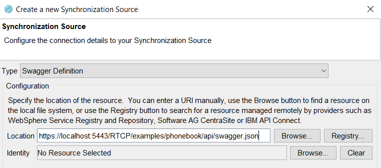

  3. Right-click Phonebook Swagger Definition and copy the URL, which is https://localhost:5443/RTCP/examples/phonebook/api/swagger.json.

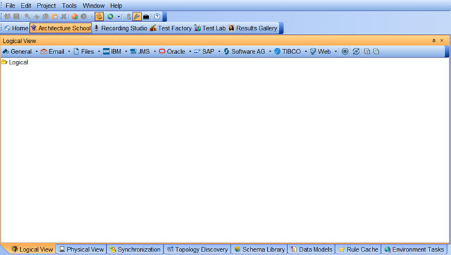

  4. Return to the Test Integrations and APIs window and navigate to Architecture School > Logical View.
    The canvas on which you model the system is displayed.
    Image of the Logical View window.
  5. Paste the URL onto the canvas either by clicking Edit > Paste or by clicking the Paste icon in the toolbar.
    The Create a new Synchronization Source window is displayed.
    Image of the Synchronization Source window.
  6. Click Next.
You have successfully created the Swagger definition in Test Integrations and APIs. The service components and operations are created in the background.

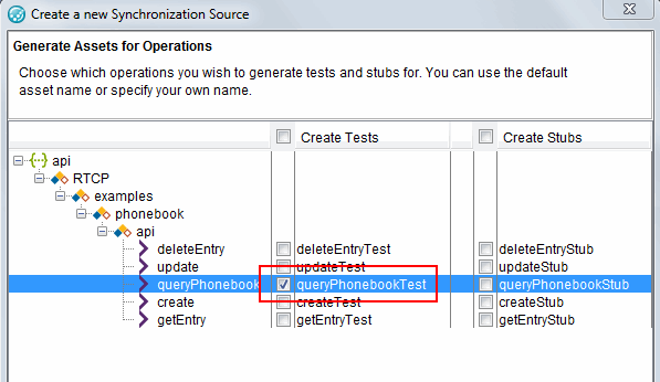

  1. In the Generate Assets for Operations page of the Create a new Synchronization Source window, select the queryPhonebookTest check box under the Create Tests column as shown in the following image.
    This action creates a test for the GET examples/phonebook/api/ request based on the Swagger definition.
    Image of the Create a new Synchronization Source window.
  2. Click Next.

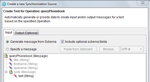

    The Create Test for Operation: queryPhonebook window displays the schema fields for the test to be created, including those that are optional as shown in the following image. The optional fields are displayed in grey, which means that the values can be supplied to the service operation but are not mandatory.
    Image of the Create Test for Operation: queryPhonebook window.
  3. Clear the Include optional schema fields check box.
    The test to be created will then request for all of the entries of the Phonebook.
  4. Click Next.

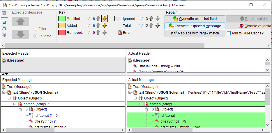

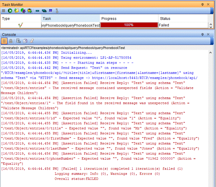

  1. Click any line in the test console that includes the phrase: Assertion Failed.
    Image of the console log window.
    This action opens a window in which you can compare the expected message (on the left) with the actual message that was received (on the right).
    image of the Window to compare messages.
    The test contains the structure of the message which was loaded from the Swagger definition, but does not contain any data against which the HTTP response can be verified. The panel at the bottom shows a list of the assertion failures.
  2. Click Overwrite expected message.
    This action replaces the expected message with the actual message received. Overwriting the expected message is just one of the several options to modify tests from an actual received message.
    More options, including those to make the verification more flexible and tolerant of variation, are described in Viewing message differences to repair validation errors.
  3. To save the changes and run the test again, click Close and Re-run.
The test finishes successfully.

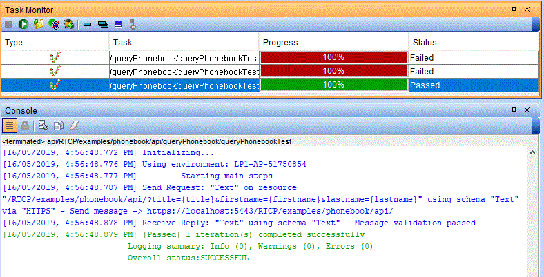

  1. To view the message that was received by the test when it ran, click the line that contains the Receive Reply: phrase.
  2. To view the message that the test sent to the API being tested, click the Send Request: phrase.
    Image of the Console log.
  3. Right-click the line that contains the Receive Reply: phrase and click Open Action.
    This action opens the Test Factory perspective, and the test and action editors. You can then view the data that was saved in the Receive Reply: action. This data was used to validate the response received from the API when the test was run.
    You can similarly view the data for the Send Request: action. You can see the data that was used in the request sent by the test to the API.
