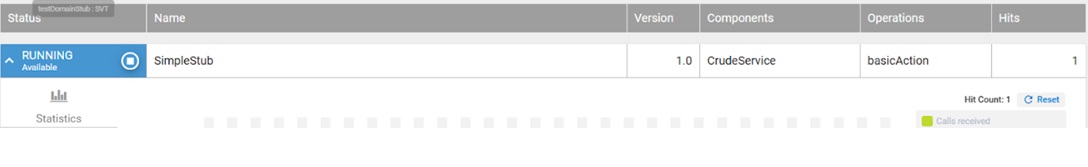

After the stub has started, the status changes from Stopped to Starting, and then the status changes to Running. After the stub runs, you can view the following details about the stub in a tabular format:

Hits
Displays the count of the messages or calls received by the stub after the stub was started.
For example, when you start a stub named as McStub with version 1.0 that was created in the Add operation under the AddNumbers service component and that had a hit count of 4, the stub is displayed in the Environments Dashboard as follows:
Image of the stub in the environments dashboard.
Starting from 11.0.7, you can reset the hit count without stopping the stub. When you expand a stub, the Statistics tab opens by default, and a Reset button is displayed next to the hit count. Click Reset to clear the hit count and set the value to 0. This action does not restart or interrupt the stub.
