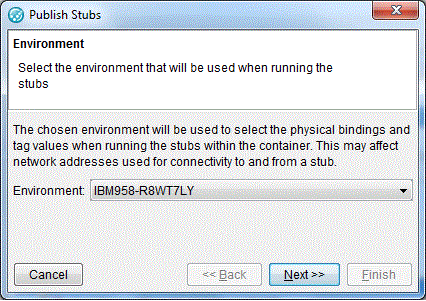

  2. Select an environment for Test Integrations and APIs to use while running the stubs.
    Image of the Publish Stubs window.
  3. Click Next.

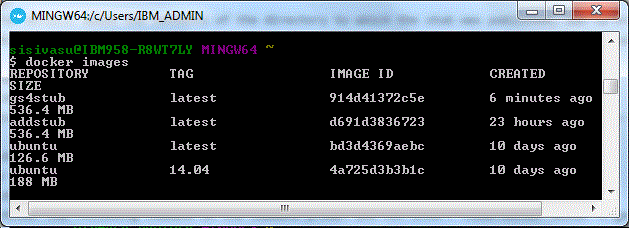

  3. To verify that the Docker image of the stub is successfully built, run the following command:
    docker images
    Image of the command window showing the docker images.

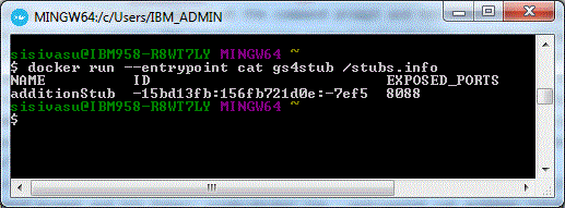

  4. Optional: To verify that it is the additionStub that has been built into the gs4stub image, run the following command:
    docker run --entrypoint cat gs4stub /stubs.info
    Image of the command window showing the command run.

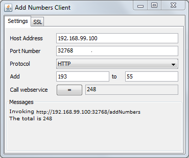

  1. Find the IP address of the Docker machine on which the stub is running. To do so, run the following command:
    docker-machine ip.
    Note down the IP address, for example, 192.168.99.100.
  2. Open the Add Numbers client.
  3. In the Host Address field, enter the IP address you noted down in Step 1.
  4. In the Port Number field, enter the port number you have noted down in Step 2 of Running the stub in a Docker container, for example, 32768.
  5. Click the equal sign to run the add operation and verify the result.
    Image of the Add Numbers client window.

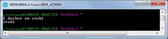

  2. To remove the Docker container, run the following command:
    docker rm stub1
