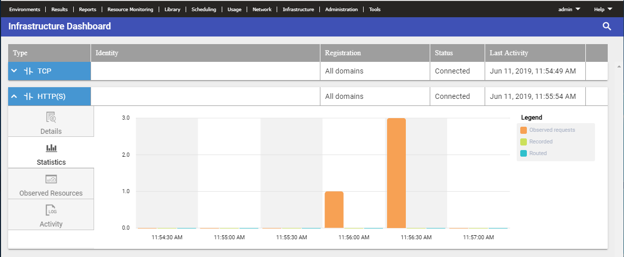

  3. Click the Infrastructure icon on the Test Virtualization Control Panel Home page to view the connected agents or proxies.
    Image of the Test Virtualization Control Panel Home page.
    Two entries are listed on the Infrastructure page, one for the HTTP/TCP Proxy’s HTTP and HTTPS proxy capability, and the other for the HTTP/TCP Proxy’s TCP proxy capability. You can view the requests received by the proxy from the Statistics panel. You can also view the activities that were logged from the Activity panel.
You have verified that the Add Numbers client application is using the HTTP proxy.

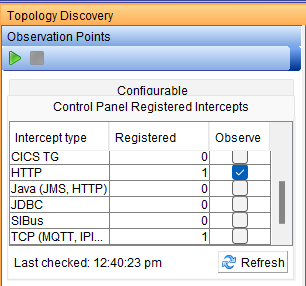

You must discover the endpoints that are in use by the Add Numbers client application by selecting the intercepts registered with Test Virtualization Control Panel.
Topology discovery is the process of observing and modeling the components of a system under test by using only real traffic that flows through the system. You can view the resources that the system calls and choose the ones to include in the system model within your project. You then use this model to make detailed recordings of interactions and create tests and virtual services from those recordings. Topology discovery, recording, and service virtualization all require the HTTP proxy. Therefore, if you configure the HTTP proxy for the client for any one of these tasks, you need not do anything separately for the other tasks.

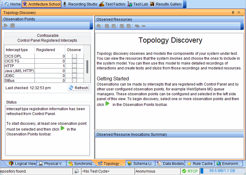

  1. Return to Test Integrations and APIs Home page, and on the toolbar, click Architecture School.
  2. Click the Topology Discovery tab.
    Image of the Topology Discovery tab.
  3. The Observation Points panel lists the Topology Discovery intercept types that are registered with Test Virtualization Control Panel. If the HTTP/TCP proxy has started you can see 1 against both HTTP and TCP. To discover the HTTP endpoints, select the check box next to the intercept type, HTTP.
    Image of the Observation Points window.
  4. Click Start discovery.
    This action starts topology discovery by using the selected intercept type. A dialog titled Starting Discovery in Control Panel is displayed.

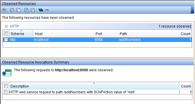

  6. Return to Test Integrations and APIs. After a few seconds, you can see a new line being displayed in the Observed Resources panel, which describes the Add Numbers server endpoint to which the request was sent.
  7. Click the row to see the information about the request that was observed.
    In the Observed Resource Invocation Summary panel, the description shows HTTP web service request and that it had a SOAPAction value of Add. This view summarizes large numbers of endpoints and invocations. You can use it to observe all the activities in a large, complex system, and find the endpoints that you are interested in testing or virtualizing.
    Image of the Observed Resources window.
  8. Select the check box next to either the endpoint (in the top section) or the description (in the bottom section).

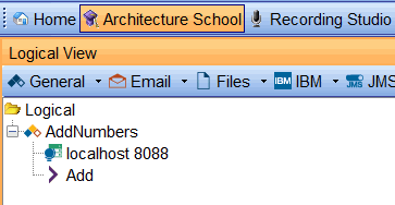

    In the Logical View, you can see the component named AddNumbers containing an operation named Add that you observed, along with the localhost 8088 HTTP transport that the operation used.
    Image of the AddNumbers component in the Logical View perspective.
You have discovered the endpoints used by the HTTP proxy when running the Add Numbers client application.

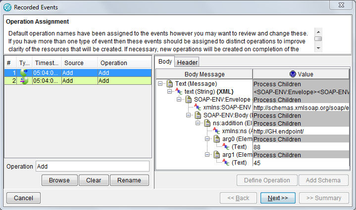

  9. In the Events View toolbar, click the Create Stub from selected events icon.
    This action opens the Recorded Events wizard where you can use the selected events to create a stub. The Operation Assignment page shows the events and that operation they are related to.
    Image of the Recorded Events window.
  10. Click Next.
    On the Transaction Assignment page, you control which request is grouped with which reply. In this case, you have only one request and reply, so they are put together into Group# 1.
  11. Click Summary.

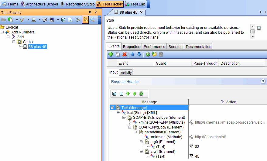

  12. Enter the stub name as 88 plus 45.
  13. Click Finish.
    The stub is opened in Test Factory.
    Image of the Stub window.

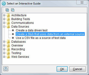

    When virtualizing a real system, you create a more complex stub that either eliminates the need for the real server to be running when testing is in progress, or that simulates a difficult-to-recreate scenario. For example, an error case from the server application to aid testing of how the client application deals with such cases. For references on creating more complex and flexible stubs, see What to do next.
    An option is to use a data source from which a stub can look up data based on the message it received. For instructions on how to create a data-driven stub, complete the following steps:
    1. In the Test Integrations and APIs Home page, click Help > Interactive Guides.
    2. Click Select an Interactive Guide.
      Image of the Interactive guides list.
    3. Select Data Sources > Create a Stub that uses data from an external source and click OK.
      Image of the Select an Interactive Guide window.
    4. Follow the steps in the Interactive Guides view.
You have successfully created, run, and verified a virtual service (message-based stub) that uses an HTTP proxy as a transport for messages.
