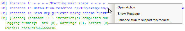

If no match is found and you have a default case (a message with a No Match guard), an entry is displayed for the default case on the stub console. You can right click the entry for a list of options, as shown in the following illustration.
menu options include Enhance stub to support this request.
If you click Show Message, the Message Differences window is displayed. See The Message Differences window for stubs in this topic. For the other options, see Console options in this topic.

Enhance stub to support this request Default Adds the incoming message to the Events list in the stub.
