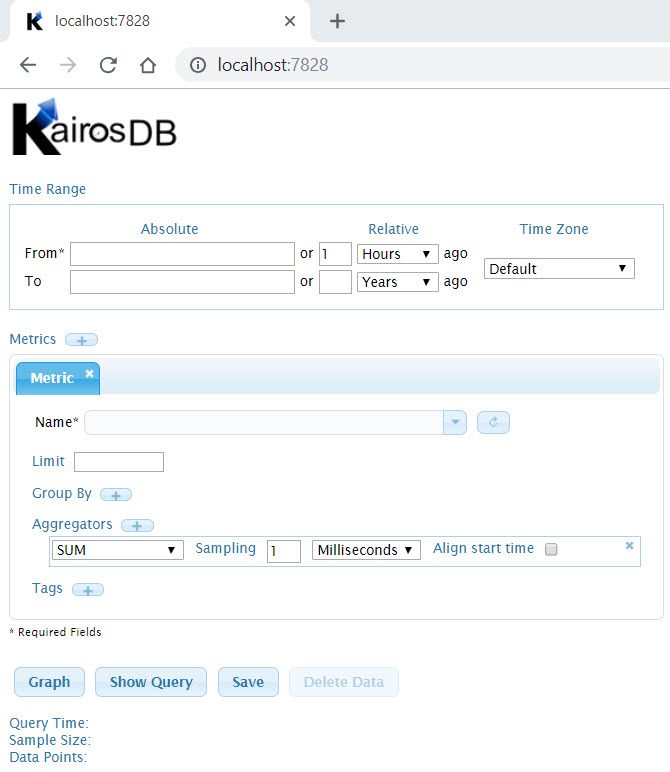

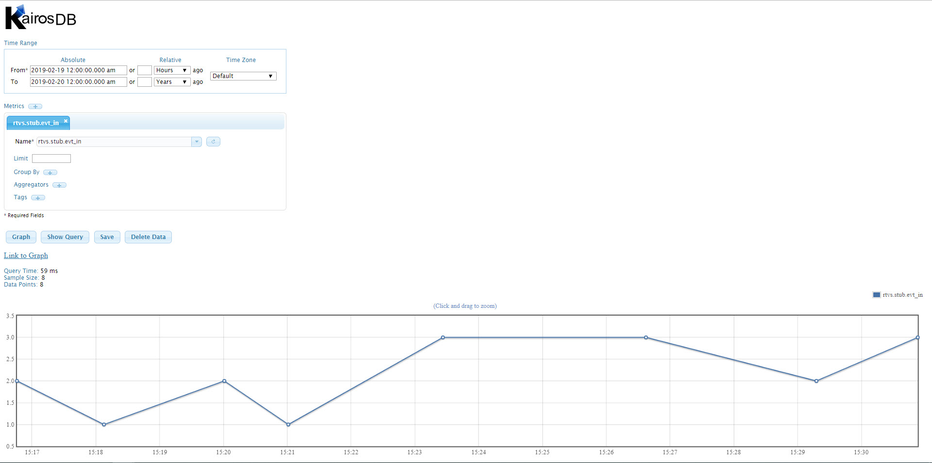

Launching the KairosDB UI
To view the query and the graph of the metrics for the stubs running on HCL DevOps Test Virtualization Control Panel (Test Virtualization Control Panel), you must launch the KairosDB UI.
You must complete the prerequisite tasks before you launch the KairosDB UI. You must use a browser on the same system that is running the Test Virtualization Control Panel instance.
Use the URL
http://localhost:7828/to launch the KairosDB UI.The KairosDB UI is displayed as shown in The KairosDB UI.
Figure 1. The KairosDB UI
Note:The mandatory fields to be selected are marked with an Asterisk (*). -
Before you generate a graph for the metrics, complete the following
steps:
- Select a time range.
- Select one or more metrics.
You can then view the graph for the details you specified. You can also add Tags or Aggregators to generate custom views for the data values of the metrics.
You have successfully launched the KairosDB UI. However, you must configure more settings to view the graph.

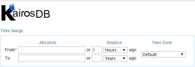

Selecting a time range and the time zone
You must first select the time range during which the KairosDB collected the metrics for the stubs. The time would correspond to the time when the stubs ran on Test Virtualization Control Panel.
You can also find the time when the stubs ran by using the Usage page accessed from Test Virtualization Control Panel. For more information, see Viewing usage statistics of virtual services in DevOps Test Virtualization Control Panel.
Launch the KairosDB UI.
See Launching the KairosDB UI. The Time Range panel in the UI is as shown in The Time Range panel.
Figure 2. The Time Range panel
In the Time Range panel, select one from the following options:
- Specify the Time Zone by selecting one from the list or let the Default time zone remain unchanged. The default time zone corresponds to the server time zone on which the Test Virtualization Control Panel runs.
You have successfully configured the time range and the time zone by using the KairosDB UI.

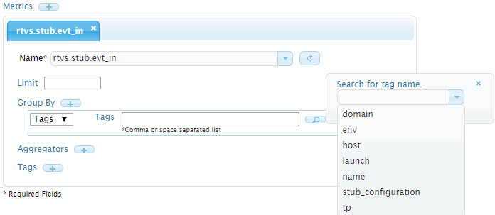

- To add a grouping item, click the
icon adjacent to Group By label. - Select Tags from the list. The screen shown in
The Group by panel
is displayed.
Figure 6. The Group by panel
- Enter the tags you want to select for the data points in the
Tags field. You can also use the
Search icon (
) and add the tags from the list displayed for the metric. See Adding Tags to the group.
Figure 7. Adding Tags to the group

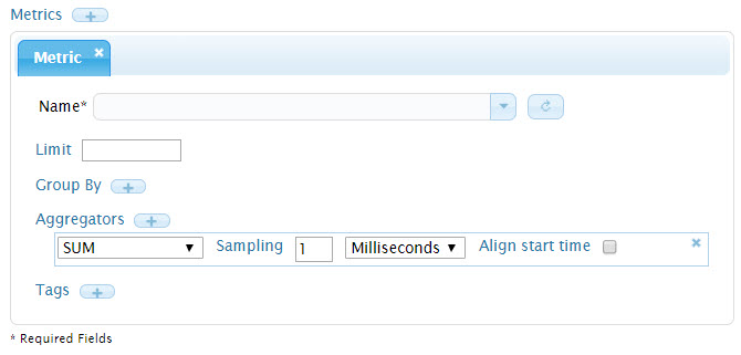

Assigning aggregators
After you group the data points, you can assign aggregators to the grouped data points so that the selected operation is performed on the data points. For example, you can count the number of data points that exist in a 10-minute time period.
To add an aggregator, click the
icon
adjacent to Aggregators.
The screen shown in The Aggregators panel is displayed.Figure 14. The Aggregators panel
Select an aggregator from the list.
The list shown in List of aggregators is displayed.
Figure 15. List of aggregators
- Enter the number of data points you want to group in the Sampling field.
- Select the time value from the list for the grouping.
- Optional: Click the Align start time check box if the grouped data points must have the same starting point in the graph.
- Click Graph to view the graph for the query created.
The graph is displayed for the query you created.

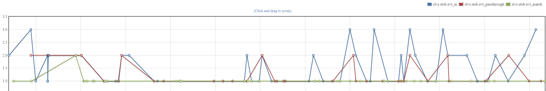

Viewing the graph
You can view the graph for the query you created using the KairosDB UI. You can view the graph at any stage of the query you are creating.
- You have set up the database to collect the data points for the stub metrics, published stubs, and ran tests in HCL DevOps Test Integrations and APIs (Test Integrations and APIs).
- You have launched and set the time range in the KairosDB UI.
- You have selected the metrics for which you want to view the graph.

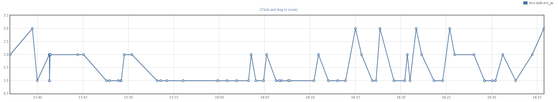

In the KairosDB UI, click Graph.
The graph shown in Graph of the stub metrics, as an example, is displayed for a query for the stub metrics in the selected time range.
Figure 19. Graph of the stub metrics

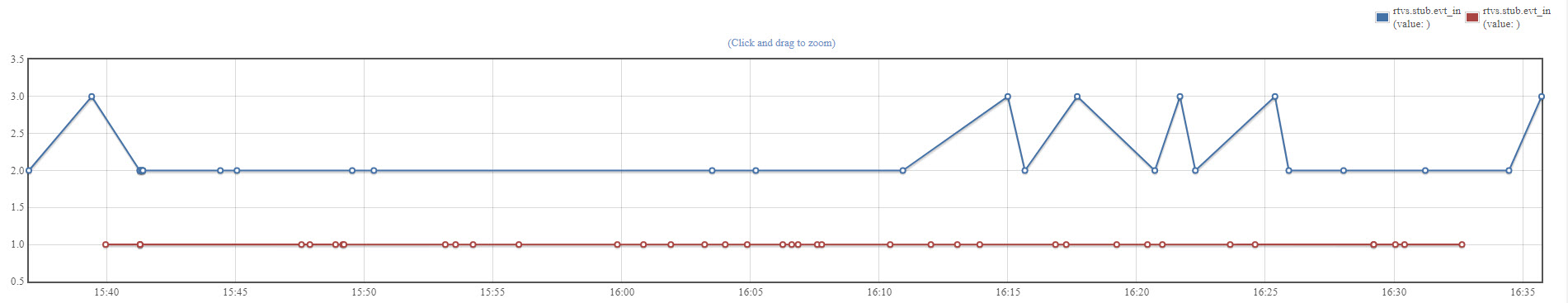

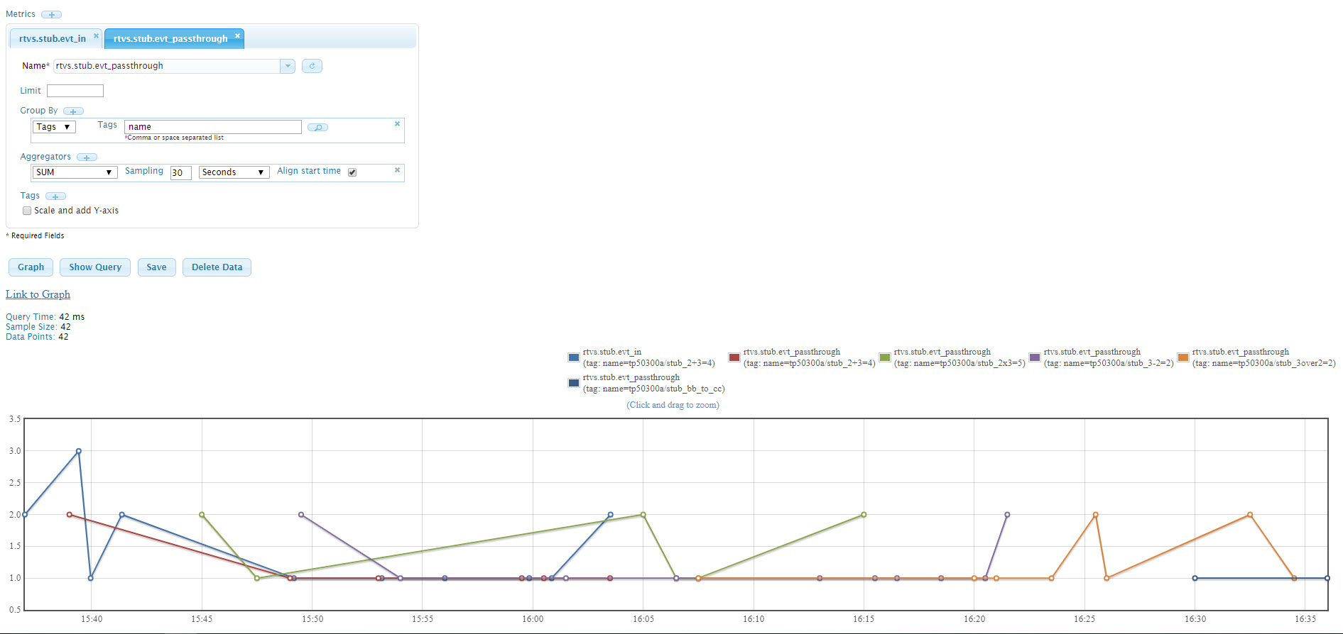

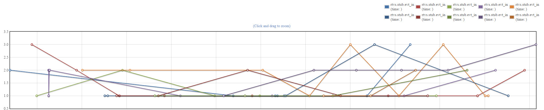

When you create a query for multiple stub metrics with one of the metrics
that is grouped by tags, and an aggregator (SUM) is
assigned, and you click Graph, the graph displays. As
an example, see the graph displayed in Graph of the metrics query for
such a query.
Figure 20. Graph of the metrics query

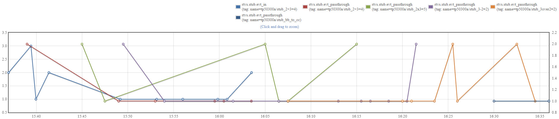

When you create a query with multiple stub metrics, the Scale
and add Y-axis field is displayed. Select this option to add
the Y-axis and scale the data series. An example graph is shown in Graph of the metrics query with scale and Y-axis
added. You can
compare the displayed graph to the graph in Graph of the metrics query to
see how the display differs because of the scaling and with the Y-axis
added.
Figure 21. Graph of the metrics query with scale and Y-axis added

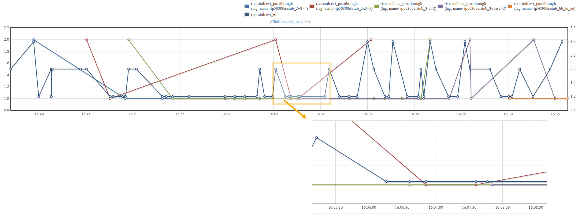

You can zoom in and enlarge part of the graph by clicking on the graph and
selecting an area you want to zoom in on as shown in View of the zoomed part in the graph.
Figure 22. View of the zoomed part in the graph
- To reset the graph to its original size, click Reset Zoom.

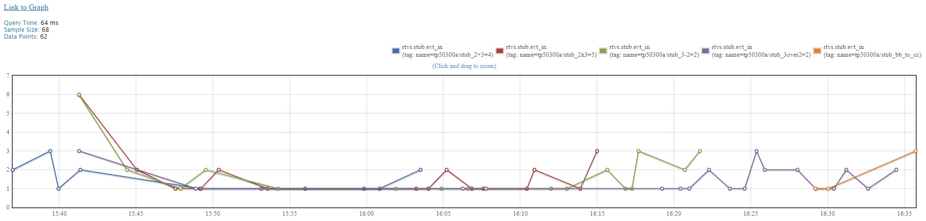

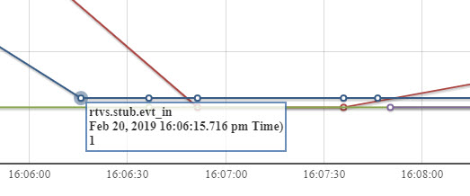

You can view the details of the data point by hovering over the data point
in the graph as shown in Hovering over a data point.
Figure 23. Hovering over a data point

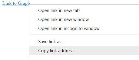

Using the link to the graph
You can create a link to the graph for your query by using the KairosDB UI so that others can use the link to view the graph.
- You must have created a query for the stub metric you are interested in.
- You must have created the graph for your query and is displayed in the UI.
In the KairosDB UI, click Link to Graph.
The graph displayed in the KairosDB UI opens in a new browser window.
You can copy the link by right-clicking the Link to
Graph link in the KairosDBUI and use the context menu option, Copy link
address as shown in Using the context menu to copy graph link.
Alternatively, you can copy the link to the graph from the new browser
window.
Figure 24. Using the context menu to copy graph link
The graph link can be used to directly view the graph in a browser.

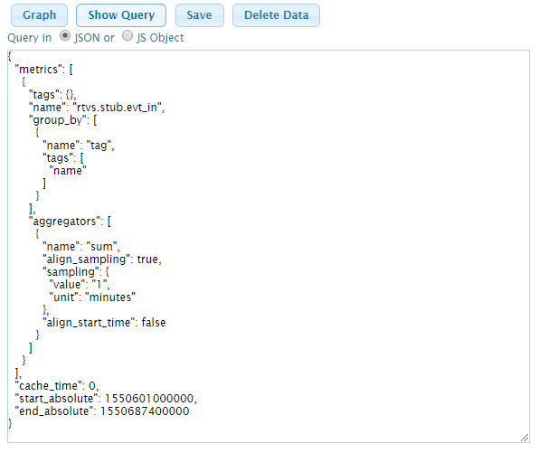

Viewing and saving the query
After you create your query by using the KairosDB UI, you can view the query and save it to the local folder that you can use later to reload the query in the KairosDB UI.
Click Show Query to view the query you created by
using the KairosDB UI. You can view the query in the JSON format or as a JS Object by
selecting the appropriate button in the displayed query.
The query is displayed as shown in the following sample.
To save the query to your local folder, click Save.
You can save the query as a CSV file or a JSON query text file by clicking the appropriate button in the dialog displayed.
- Navigate to the folder you want to save the file in, provide a name for the file, and then click Save.
