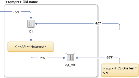

In Mirror Queues mode, HCL DevOps Test Integrations and APIs (Test Integrations and APIs) uses an WebSphere® MQ API exit, which is installed on the queue manager, to take a copy of each message and put it into another queue. Therefore, if you record multiple queues, multiple mirror queues are set up.

An example of the process is described in the following steps:
  1. Start recording on Q1.
  2. Test Integrations and APIs (Recording Studio) configures the API exit to mirror all messages that are put onto Q1 to Q1_RIT.
  3. The client puts message onto Q1 with the reply queue specified as Q1R.
  4. The queue manager triggers the API exit, which puts a copy of the message onto Q1_RIT.
  5. Test Integrations and APIs (Recording Studio) subscribes to this queue and gets the message. Test Integrations and APIs detects that message specified a reply of Q1R. Test Integrations and APIs configures the API exit to mirror all messages from Q1R to Q1R_RIT.
  6. The server picks up the message from Q1 and replies to Q1R.
  7. The queue manager triggers the API exit, which puts a copy of the message onto Q1R_RIT.
  8. Test Integrations and APIs (Recording Studio) subscribes to this queue and gets the message.
  9. The client receives the reply from Q1R. client receiving reply from Q1R
