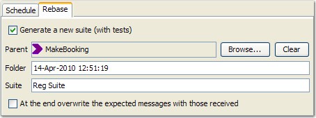

  3. Click the Rebase tab at the bottom of the dialog.
  4. Tick the Generate a new suite (with tests) option.
  5. To change the location where the new suite is created, click Browse next to the Parent field and select the wanted component, folder, or operation.
  6. Enter or modify the name of the folder in which the new suite is created in the Folder field (the current date and time is used by default).
  7. Enter or modify the name of the new suite in the Suite field.
  8. If wanted, tick the box at the bottom of the dialog to overwrite expected messages in the executed tests with the messages that are received.
  9. When finished, click Run.
    The new suite is created and executed by using the name and location specified.
