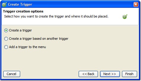

  3. Select whether you want to create a brand new trigger or create one based on an existing trigger, then click Next. If you base the new trigger on an existing one, you must select the existing trigger before proceeding.
    If you select the Create a trigger option, the selected operation must have a transport that is configured in its MEP settings.

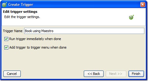

  5. Provide a name for the trigger and select whether you want to run the trigger after it is created and whether to add the new trigger to the Triggers menu in the Events View.
  6. Click Finish to create the trigger and close the wizard.
