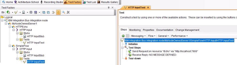

If you completed the synchronization with IBM® Integration Bus, the Test Factory view is displayed with the tests that were created.
Image of the Summary window.
  1. Select the test or stub that you want to run.
  2. Right-click the test or stub and select Run.
    The selected test or stub runs, and the Test Lab view is displayed with the results of the run.
