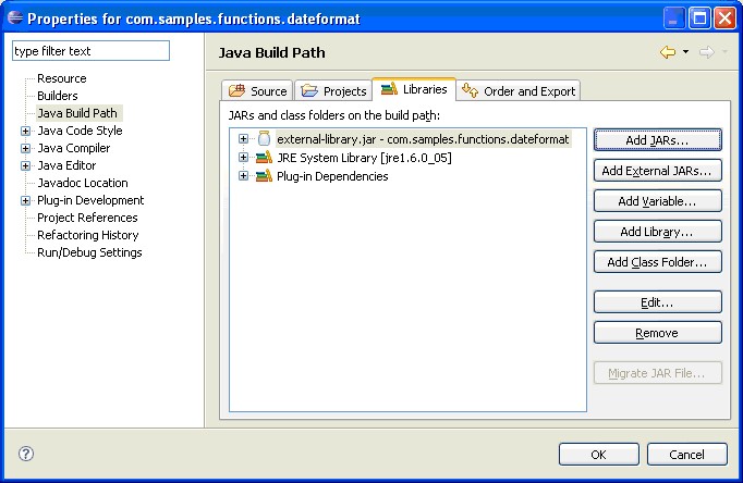

    1. Right-click the project and select Properties > Java Build Path > Libraries.
    2. Click Add JARs and browse for the JAR you just added under the plug-in project.
    3. Close the Properties dialog.
