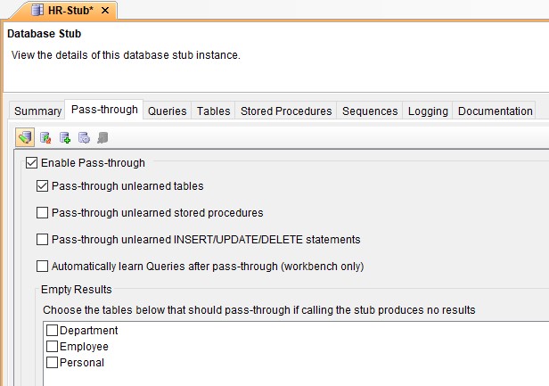

Pass-through unlearned tables
Consider you have a new table that the JDBC database application accesses to show a list of buildings. However, this table is not part of the stub. You need the data from the building table to completely test the application. So you must get the data from the real database instead.
This can be accomplished by following these steps:
  1. Select Enable Pass-through on the Pass-through tab of the Stub editor.
  2. Select the Pass-through unlearned tables check box.
  3. Save the stub and run it.
image of the pass-through unlearned tables
Now, when you run the JDBC database application, you can get the required data back from the real database and continue testing your application instead of receiving an exception about missing data.

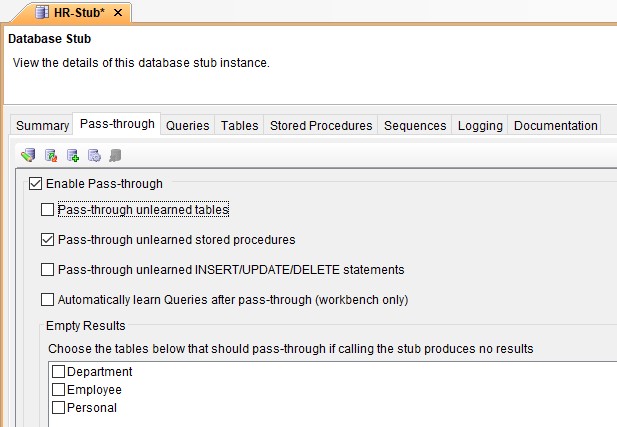

Pass-through unlearned stored procedures
Consider that there have been several new stored procedures that were developed and that the JDBC database application uses. Unfortunately, the new stored procedures do not exist in the stub and you might get an error when you try to use them while virtualizing. You must test the stored procedures called by the application without modifying the stub data.
  2. Select the Pass-through unlearned stored procedures check box.
image of the pass-through unlearned stored procedures
Now, the JDBC database application can use stored procedures in the real database that do not exist in the stub while virtualizing, without receiving any error about the missing data.

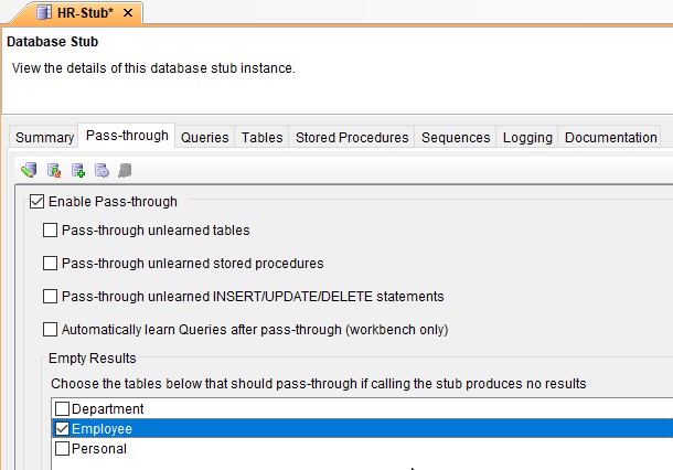

Empty Results
Consider you have a table in the stub, called Employee which is queried by the JDBC database application, but the query returns no data and no errors are displayed. It means that the data you look for is not found in the data stored in the stub. When you further test, you must check the real database to see if any records exist, that match your query without altering the stub.
  2. Select the Employee table in the Empty Results table.
image of the pass-through emplty results tables
Now any records that match the JDBC database application’s query in the real database are returned instead of empty results from the stub and you can complete your testing.

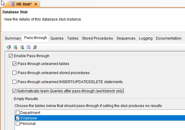

Automatically Learn Queries after pass-through
Consider you have added new tables of data in your database that you access from the JDBC database application. Also, you must ensure to add the queries and data from those tables to the existing stub by not modifying the stub manually.
  1. Select Persistent on the Summary tab of the Stub editor.
  2. Select Enable Pass-through on the Pass-through tab of the Stub editor.
  3. Select the Pass-through unlearned tables check box to learn queries and data from tables that do not exist in the stub.
  4. Select tables in the Empty Results list to learn data from the real database when the stub returns empty results for a query.
  5. Select the Automatically learn Queries after pass-through (workbench only) check box.
image of the pass-through automatically learn queries
