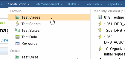

Navigating Rational® Quality Manager
Test Integrations and APIs resources can be viewed in the Construction menu of the Rational® Quality Manager console, as Test Cases and Test Scripts.
Construction menu of Rational Quality Manager

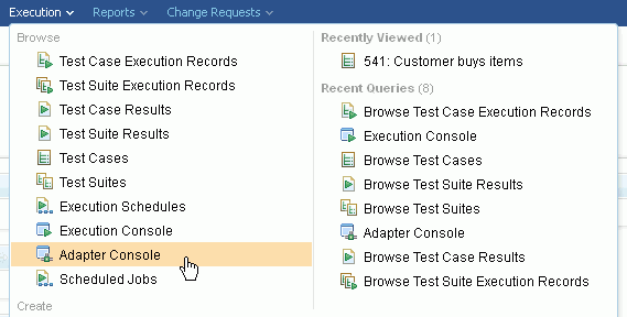

The Test Integrations and APIs Agent, once running, can be seen as an Rational® Quality Manager Adapter by selecting Adapter Console from the Execution module.
Adapter console menu
