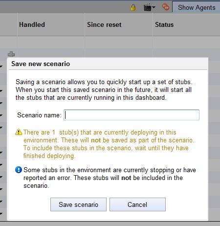

By saving a scenario, you can quickly start a set of stubs. When you start a scenario, it will start all the stubs that are currently running in the dashboard.
Save new scenario
