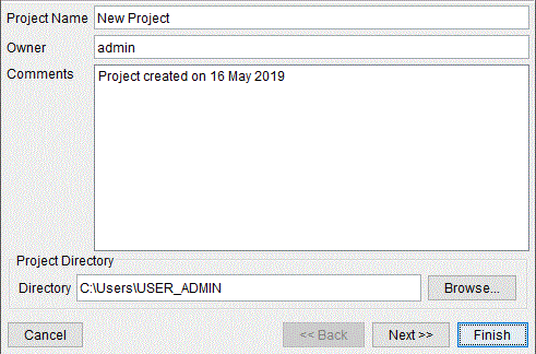

- In the startup window, select Create Project and click OK.
- Enter a name for the project in the Project Name field.
Click Browse and select a location to save the project.
If you do not browse and select a location, the project is saved in the default location, which is your home directory. For example, the default location is C:\Users\USER_ADMIN.
Click Finish.

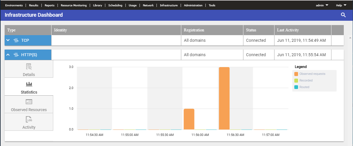

In a web browser, open Test Virtualization Control Panel
by going to
https://localhost:5443/RTCP.The Test Virtualization Control Panel Home page is displayed.
Click the Infrastructure icon on the Test Virtualization Control Panel Home page to view the
connected agents or proxies.
Two entries are listed on the Infrastructure page, one for the HTTP/TCP Proxy’s HTTP and HTTPS proxy capability, and the other for the HTTP/TCP Proxy’s TCP proxy capability. You can view the requests received by the proxy from the Statistics panel. You can also view the activities that were logged from the Activity panel.
You have verified that the Add Numbers client application is using the HTTP proxy.

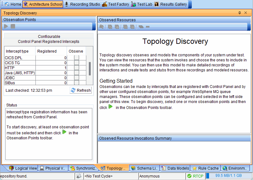

- Return to Test Integrations and APIs Home page, and on the toolbar, click Architecture School.
Click the Topology Discovery tab.
The Observation Points panel lists the Topology Discovery
intercept types that are registered with Test Virtualization Control Panel. If the HTTP/TCP proxy has
started you can see 1 against both

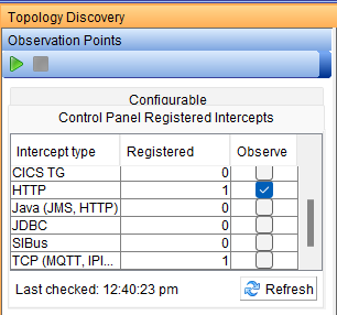

HTTP and TCP. To discover the HTTP
endpoints, select the check box next to the intercept type,
HTTP.
Click Start discovery.
This action starts topology discovery by using the selected intercept type. A dialog titled Starting Discovery in Control Panel is displayed.

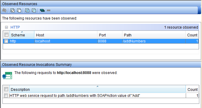

- Return to Test Integrations and APIs. After a few seconds, you can see a new line being displayed in the Observed Resources panel, which describes the Add Numbers server endpoint to which the request was sent.
Click the row to see the information about the request that was observed.
In the Observed Resource Invocation Summary panel, the description shows HTTP web service request and that it had a SOAPAction value of Add. This view summarizes large numbers of endpoints and invocations. You can use it to observe all the activities in a large, complex system, and find the endpoints that you are interested in testing or virtualizing.

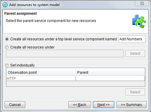

On the Parent assignment page, choose a name for the new
component to contain the observed operations. As the application observed is called
Add Numbers, enter the same name.

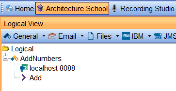

In the Logical View, you can see the component named AddNumbers containing an operation named Add that you observed, along with the localhost 8088 HTTP transport that the operation used.

At this stage, the Logical View of the Architecture School perspective shows the component named AddNumbers containing an operation named Add, along with an HTTP transport.

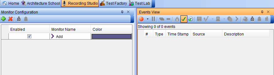

- Click the service operation called Add, to select it.
Click Add event monitors for the selected items on the
toolbar.
Test Integrations and APIs switches to the Recording Studio perspective and adds an Event monitor for the Add operation, which you can see in the Monitor Configuration panel.
In the Events View toolbar, click the Start
Recording icon.
You see a progress dialog for a few seconds while the proxy is configured for recording.

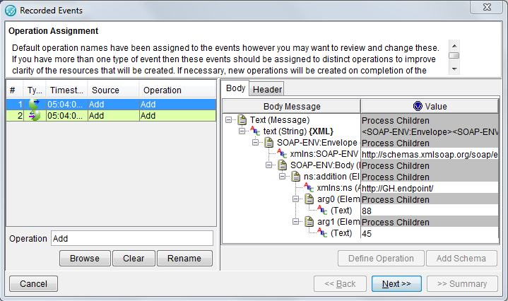

In the Events View toolbar, click the Create Stub
from selected events icon.
This action opens the Recorded Events wizard where you can use the selected events to create a stub. The Operation Assignment page shows the events and that operation they are related to.
Click Next.
On the Transaction Assignment page, you control which request is grouped with which reply. In this case, you have only one request and reply, so they are put together into Group# 1.
- Click Summary.

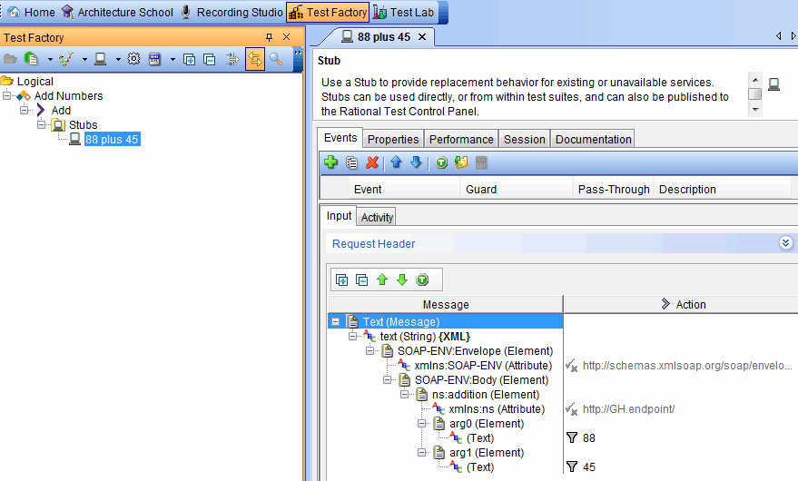

- Enter the stub name as 88 plus 45.
Click Finish.
The stub is opened in Test Factory.

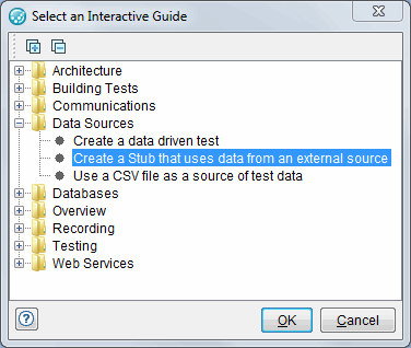

When virtualizing a real system, you create a more complex stub that either eliminates the need for the real server to be running when testing is in progress, or that simulates a difficult-to-recreate scenario. For example, an error case from the server application to aid testing of how the client application deals with such cases. For references on creating more complex and flexible stubs, see What to do next.
An option is to use a data source from which a stub can look up data based on the message it received. For instructions on how to create a data-driven stub, complete the following steps:
You have successfully created, run, and verified a virtual service (message-based stub) that uses an HTTP proxy as a transport for messages.
What to do next
- To control what requests the stub must respond to, you can use the stub editor’s Input tab and The Field Editor. For instructions, see The Input tab.
- To control how the stub constructs responses, you can use the stub editors Activity tab and The Field Editor. For instructions, see The Activity tab.
