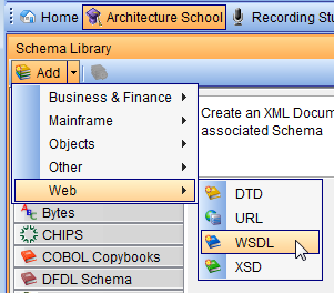

- Click the Add button to specify a source file. Test Integrations and APIs attempts to determine the schema type from the source file contents.
- Click the arrow next to the Add button
to specify the schema type to add.
When you add a schema of a category that did not previously exist in the project, the category is added to the schema list.
The information required to add a schema varies with the type of schema being added. For more information, see Schemas.
