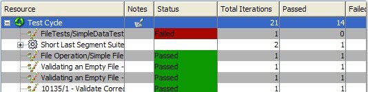

Summary and detailed reports can be displayed for one test cycle at a time. An execution summary for the selected test cycle is displayed at the top of the Results Gallery perspective.
The summary contains the following information:
| Column | Description |
| Resource | Displays the contents of the selected test cycle, with details for each resource that is provided in the remaining columns. |
| Notes® | Indicates whether a note is saved for the selected resource. |
| Status | The overall status of the selected resource, either Passed or Failed. There is no status for the test cycle. |
| Total Iterations® | The total number of iterations of the selected resource that were executed in the test cycle. For the test cycle, the total of all iterations is displayed. For a scenario, the total of all iterations for child tests is displayed. If a scenario contains child scenarios, the total of all child resources is displayed. |
| Passed | The number of iterations of the selected resource that passed. For a scenario, the total number of passed child tests is displayed. |
| Failed | The number of iterations of the selected resource that failed. For a scenario, the total number of failed child tests is displayed. |
| Start Time | The time when the selected resources execution began. |
| End Time | The time when the selected resources execution ended. |
| Exec Time (ms) | The overall time (in milliseconds) that the selected resource took to complete its execution. For the overall scenario, this time includes set up and tear down phases. |
