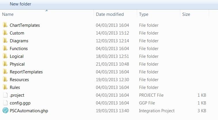

Project structure
When an HCL DevOps Test Integrations and APIs (Test Integrations and APIs) project is created for the first time, the project folder structure is created on a disk.
To implement tests and stubs, the following things are needed:
- Certain artifacts such as schemas and executable files (psftp.exe for file transfers)
- Test data in spreadsheets

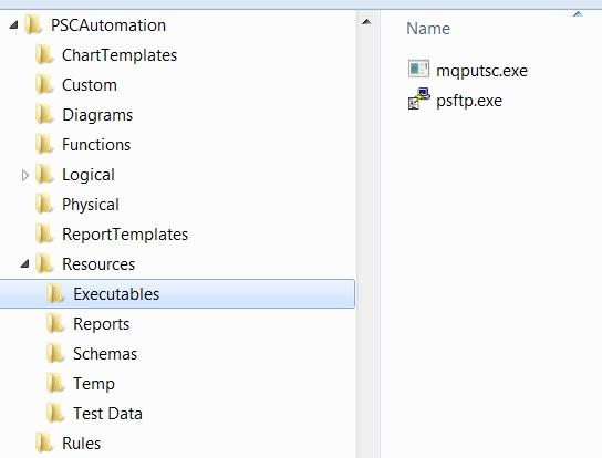

Consider the following points:
- Make sure that projects are as self-contained as possible. Moving project locations must not break tests.
- Create new folders within the project folder to store artifacts, such as schemas, test data,
executables, Apache Ant scripts, and reports.
- Where possible, put the schema source data into a project. This helps with portability of your project.
